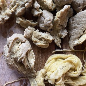

A love note to this seitan recipe. Thanks Isa! My first homemade seitan! I’m not sure that I nailed it but the texture was great.

My seitan came out very firm and meaty. It definitely had some denseness and chew — it tasted more like a cross between chicken and beef. If you have had any of the canned meatless products like Worthington, the flavor reminded me of Fri-chik — a chicken sub. It was much better though. I sliced one of the cutlets into “fingers” and dusted the outside with a blackening spice I made up. I then sauteed it in a generous amount of olive oil. When they were crusted accordingly, I coated them with barbecue sauce and let it all carmelize in the pan. It got good crunch and was very flavorful.
